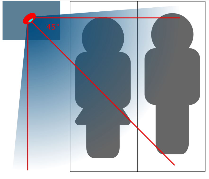

6. Positioning the device
The Phaser scans a 130 degrees wide area.
In case there are more people in the bed, to prevent interference, we recommend positioning the Phaser as seen below. In this way, you get maximum signal from yourself, while the signal from your partner is mostly blocked.
Make sure that the Phaser is open the whole night, so that the arm of the lamp doesn’t block the sensor.

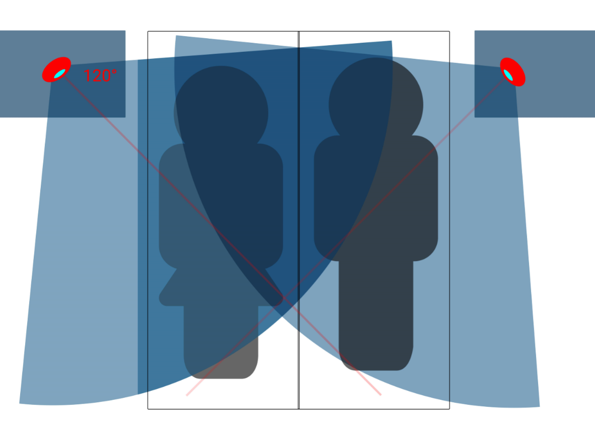

7. Tracking with two Sleep Phasers (pair tracking)
To track two people in one bed with two Phasers (Dual Phasers), make sure to enable Settings > Sleep tracking > Pair tracking on both phones and also tap Find partner simultaneously on both phones.
Position the Phasers as indicated in the image below.
Pair tracking cross-checks signals from both Phasers against each other and cleans them out so any signal from your partner is removed from your data.
For more details, see Pair tracking.
