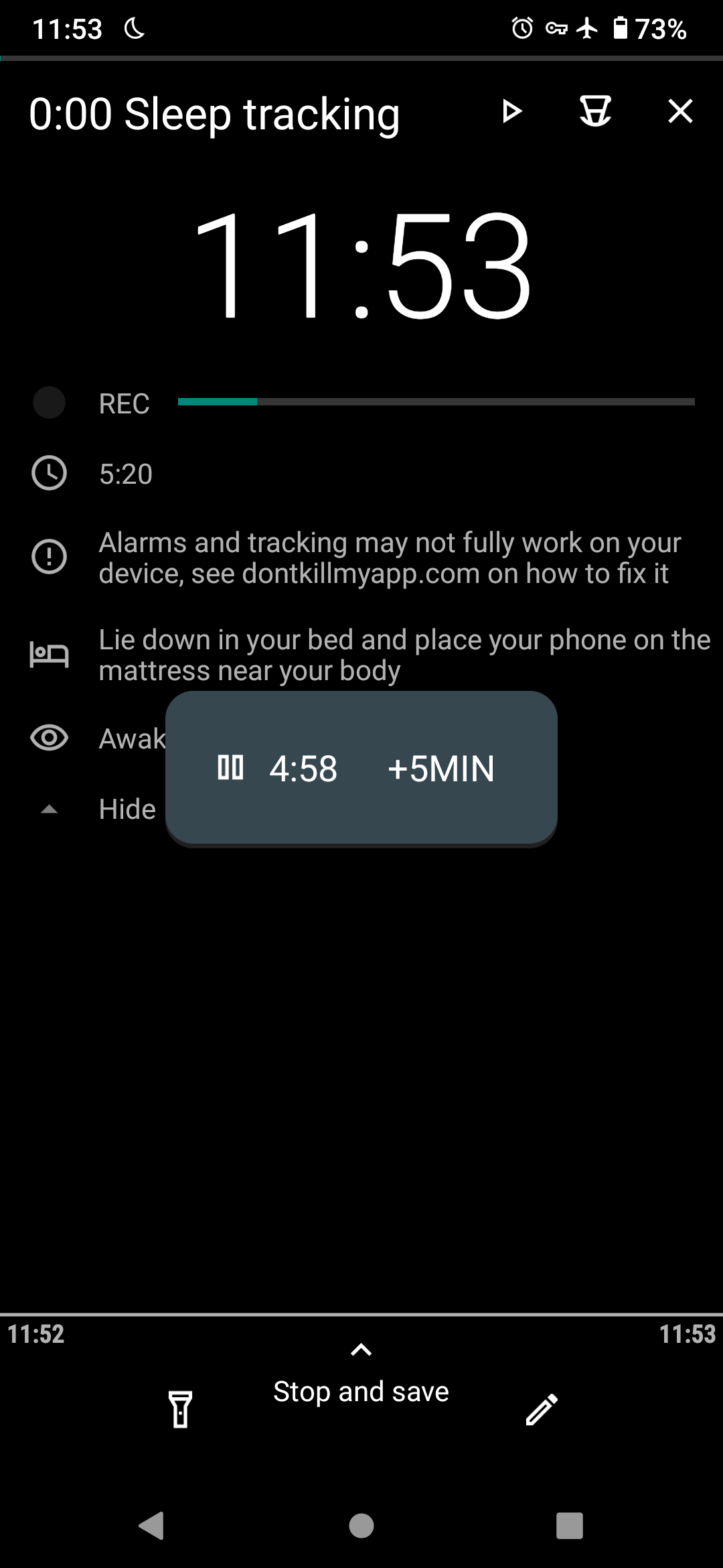

4. Pause
Use the sleep tracking pause feature whenever you are tracking but not sleeping to provide our awake detection further hints.
Pause button |
Available from sleep tracking screen, see Figure 2, “Pause tracking from the tracking screen”.
Volume / camera buttons |
Adds 5 minutes every time your press the volume of camera buttons
